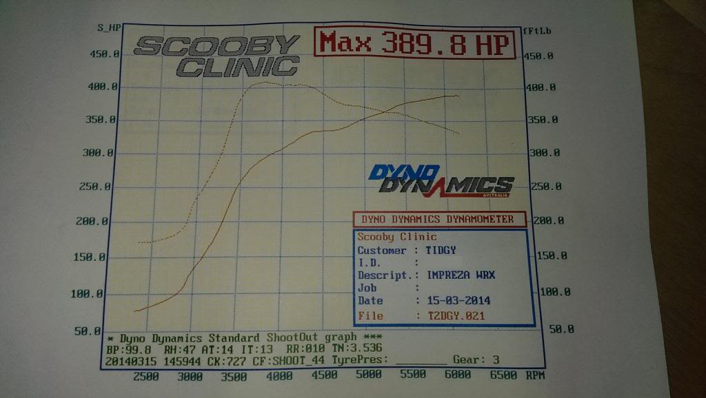

Not had a 42 for comparison im afraid. Had a 46 on my old engine, but that was a wrx with single avcs heads, and was nearer to stock than my type r is. STI top mount, stock ecu etc. My type r is on a front mount and syvecs.
Graphs of my old one, but prob a few version old of the 46 and not sure how comparable it is being a very different spec.
So they are also on a 2.5 just closer to stock ?
390 bhp at around 21 psi ? and pulls all the way to redline

yes matey, the sc46 is the near stock one.
yep, was kept low boost though so had plenty more to come

Tidgy, isn't yours a custom 28 based using a smaller housings specifically designed for spool as was made for their rally car? Hence runs out of puff, a genuine 28 will see over 400hp?
The housing is availble off the blouch website as one of the options, but mine has a custom turbine, sorry if that wasn't clear.

Yea but if you read they say they designed the Dom 1.5 for uk guys with the 2.0 so even the sc46 wouldnt really be that one,
If it is the Ball bearing 20gxtr thats equal to the 42
then how about the 18g xtr i bet that wouldnt be too far off
Im sure blouch put a 7cm on the SC ones,
You can spec it like that from them too
One of the issues with the SC series when you try to compare them is they change frequently, by that i mean they are an evolving entity with different specs and changes in housing etc, so it's hard to pin down exactly which housings are used not to mention the changing in wheel design.
So a sc46 from a couple of years ago will be a very different animal to one form this year.
IIRC the one on my old wrx was an early SC46+. But as you can see from the dates were going back a few years and my memory isn't great haha
