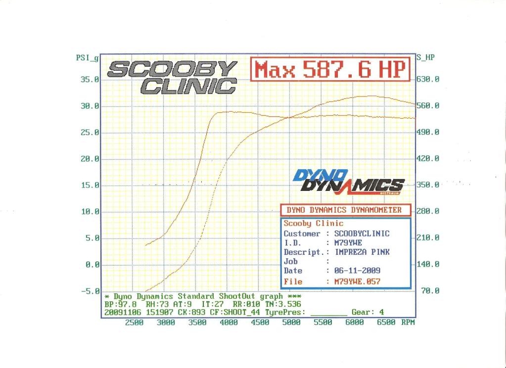

Originally Posted by frayz
Morrisons finest is E85 mate
.63 hotside is interesting?
1.9bar flat or is that at the redline? What did it run in the middle?
Whats the spec of the motor, cc, headwork, avcs, cams, manifolds etc?
Hi,
I have printed the boost curve against the bhp for you to take a look at
Spec is ..........
2.35 ltr using our stroker kit https://www.scoobynet.com/trader-ann...obyclinic.html
Standard STI 8 heads
Standard cams
Solaris ecu
GT 30R billet turbo
E85 fuel
Hope the above helps,
Thanks for your interest.
