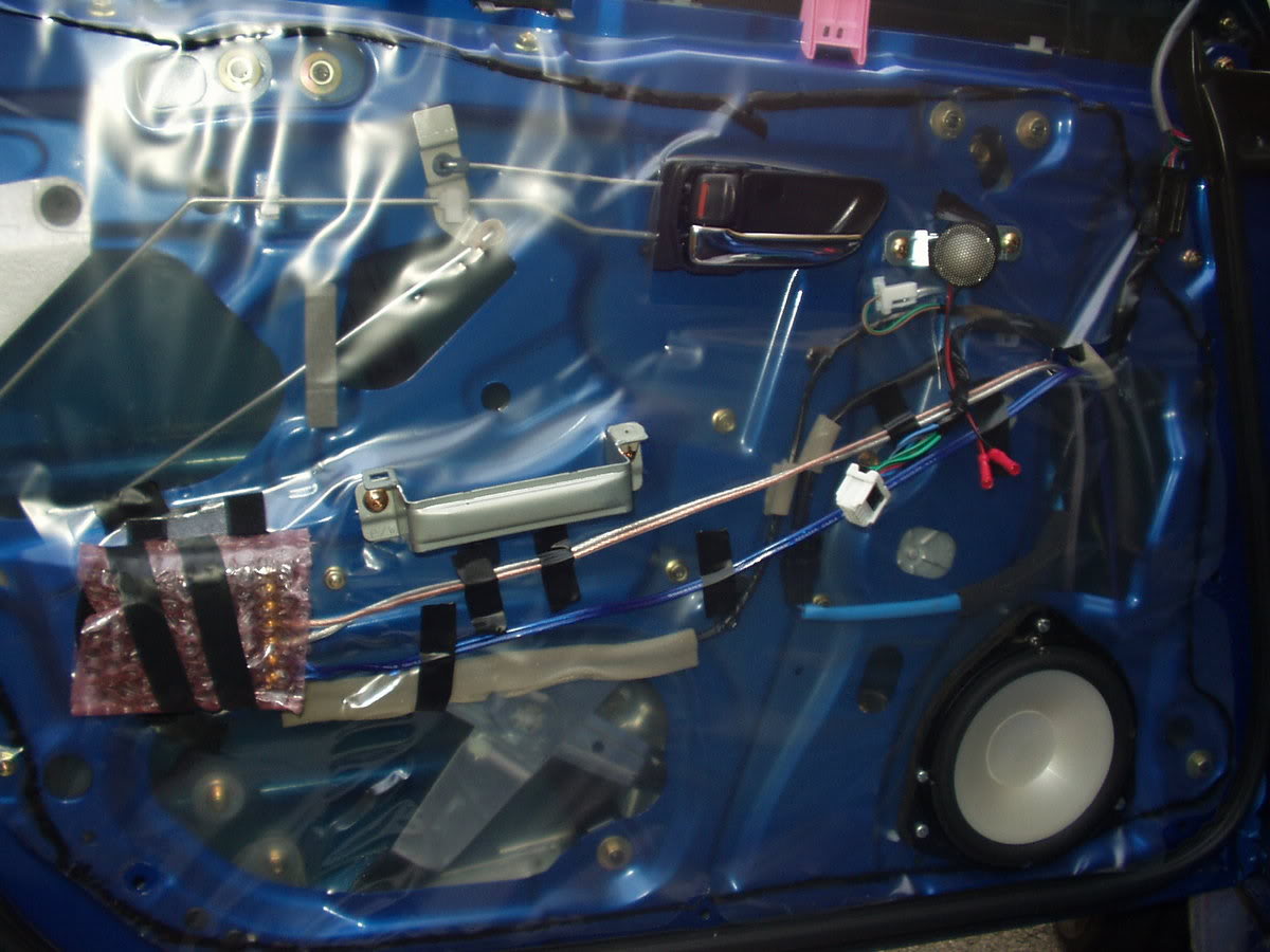

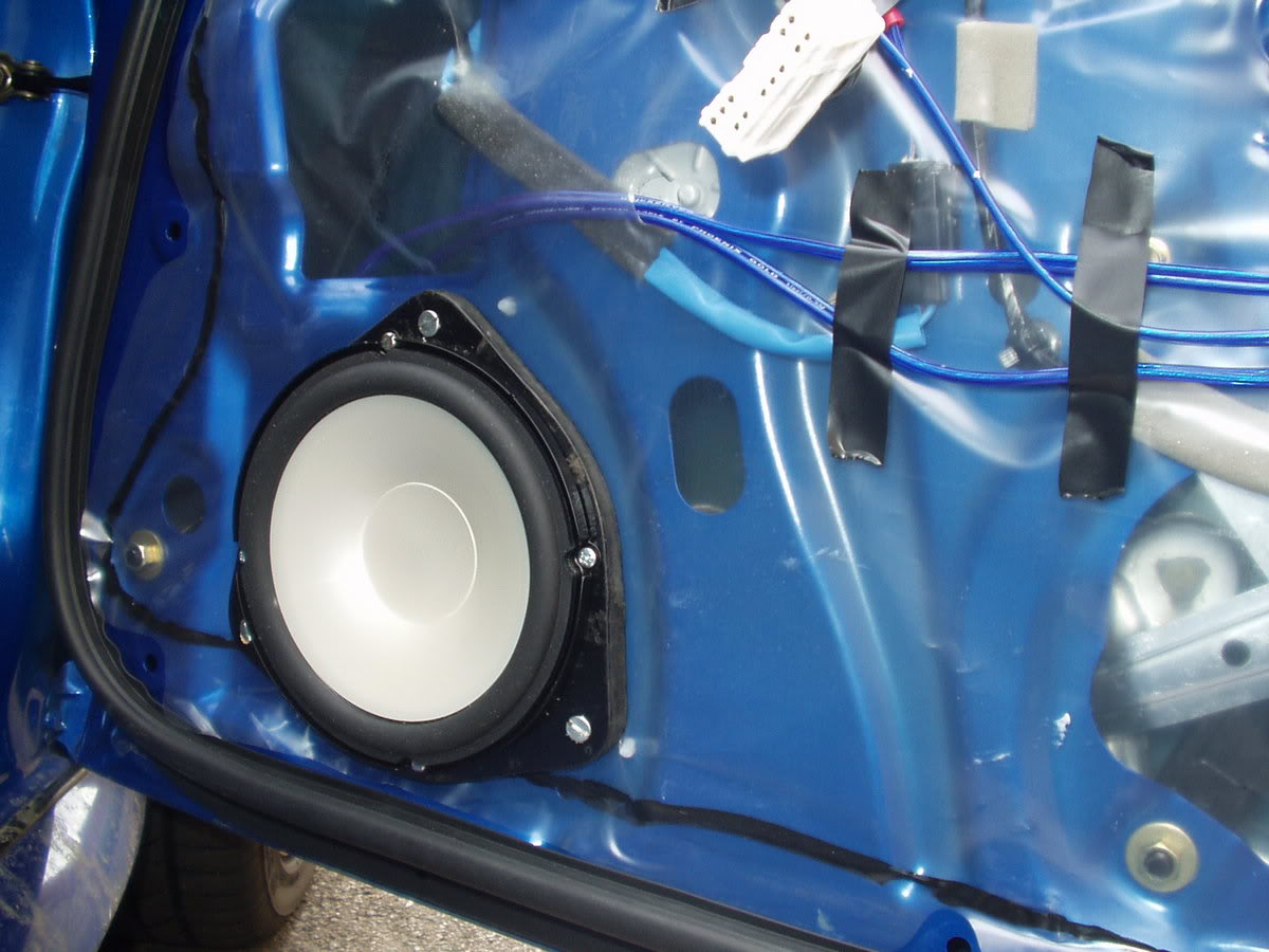

Infinity 6000cs's 6.5", with a 12mm mdf spacer. On my 03sti.
You can see the crossover wrapped in bubble wrap and velcro'd to the door.
Tweeter is also velcro'd to the old nounting bracket, very handy stuff.
Hope it helps.
